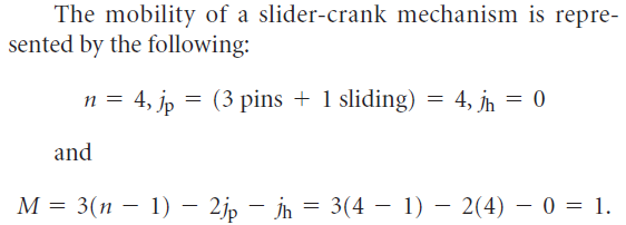

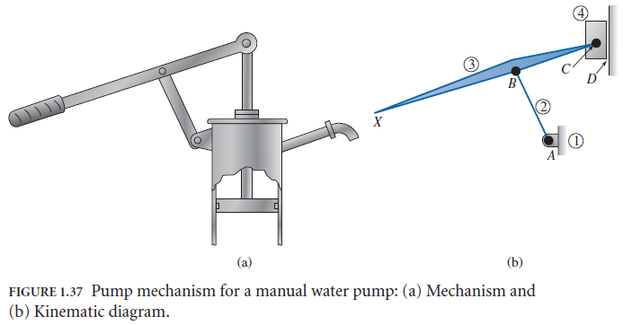

【20160324】Slider-Crank Mechanism
; K3 J/ r) ^/ L# m$ h; ^  `& Y" Q9 c6 w( v# i7 C
Another mechanism that is commonly encountered is a slider-crank. This mechanism also consists of a combination offour links, with one being designated as the frame. This mechanism, however, isconnected by three pin joints and one sliding joint. A mechanism that drives a manual water pump is shown in Figure 1.37a. The corresponding kinematic diagram is givenin Figure 1.37b.
9 R3 `: A1 B3 n% o曲柄滑块机构也很常见。事实上它也是由4个构件组成,只是其中之一被指定为机架。另外,此机构是以3个转动副、一个滑动副连接的。图示为手摇泵及其运动图示。3 r5 {. W, C' W% T3 @
! h1 m: S& S) O/ z, H5 E* B
) O7 F& _/ M2 K/ y: u) t
$ g! q, ?) O/ r% g0 k, E  L: { 未命名图片.png
* Y; [$ d: x2 G* {. q
6 E) T3 [& M; {, X" w! p( Z, [
Because the slider-crank mechanism has one degree of freedom, it is constrained or fully operated with one driver. The pump in Figure 1.37 is activated manually by pushing on the handle (link 3). In general, the pivoted link connected to the frameis called the crank. This link is not always capable of completing a full revolution. The link that translates is calledthe slider. This link is the piston/rod of the pump in Figure1.37. The coupler or connecting rod “couples” the motion of the crank to the slider.0 `- ]/ T: b* D, a( q1 }7 K
因为机构只有一个自由度,因此只需要一个主动力。一般来说曲柄无法完成整周运动。作滑移运动的构件称滑块,连接滑块和曲柄的称连杆。

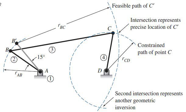

Graphical Analysis
1 S! R' \( \/ j$ a3 I1 E图解法分析步骤7 o) H  ?' ^2 `3 w" c3 O' D8 c
7 R" p$ y7 z# \1.Point B moves to B’
7 a: ]1 q* u6 {. m2.Point C must always lay on its constrained path . N0 [5 G# F0 P# d
3.The length between B and C must stay constant- ]# [- x4 C; v, A% Q
画主动件→画定轴转动轨迹→连杆长度不变→交点, o8 F% V) D9 u8 ]

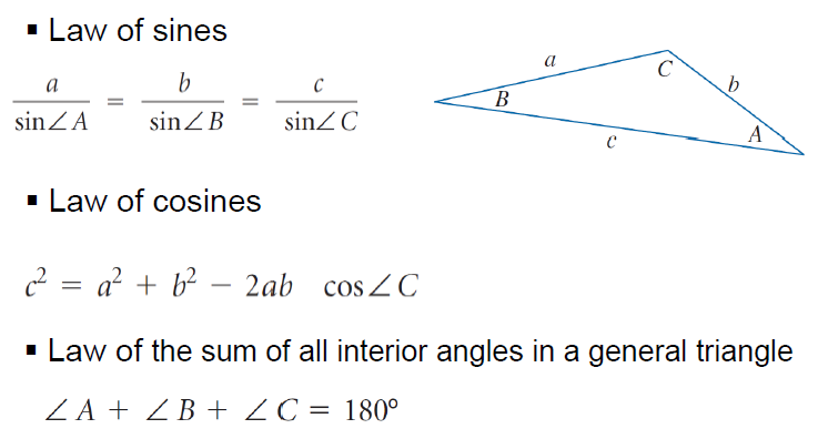

Analytical Analysis
7 ?; t) i" r0 q- g+ J; Z7 @解析法
7 J# r( i/ O- w$ i1 I
3 T" m+ S5 L: W+ x 未命名图片.png

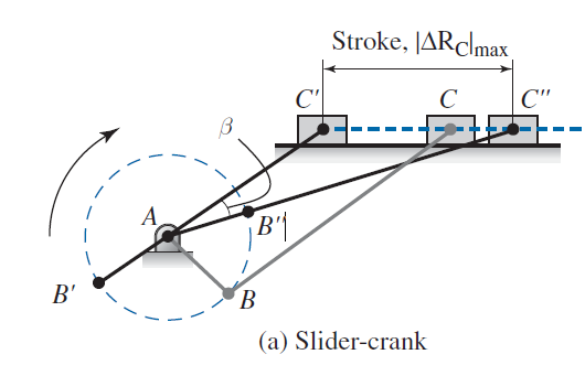

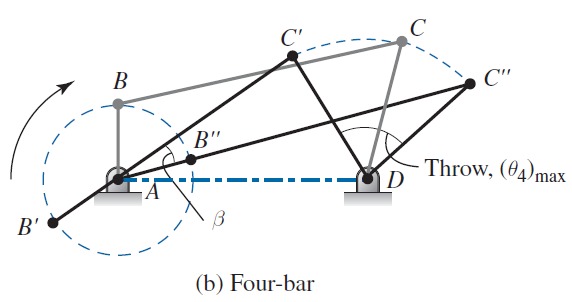

( V6 v3 y: h' P$ i, v$ P  V: rLimiting position
$ t- y8 F' q/ e6 U) |% xThe configuration of a mechanism that places one of the follower links in an extreme location is called a limiting position.
" e) _. Y1 i0 k: o2 b从动件之一处于其极限位置的机构位置称极限位置。
7 s. V( I: T1 `: c4 E& S& U8 kThe crank and coupler become collinear.  \# z$ p# m9 q* G
Imbalance angle
- the angle between the coupler configuration at the two limiting positions., z0 F! P0 _% b2 {2 t* B
曲柄和连杆共线时达到极限位置;" S8 k: i3 M% m' c6 G
极位夹角:连杆在两极限位置之间时所形成的角。

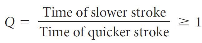

- E, z8 D; V- [& `! bTime Ratio/ }, ^7 J! R" ~- ]! ~0 \9 \# [1 W
1 t  N+ @( i4 K+ Q" m* o% U0 qKinematically balanced mechanisms:the motion characteristics of the outward stroke are identical to those of the inward stroke.0 ^6 j- Z5 K7 f1 z* o" K2 J& v
运动对称机构:内外冲程等时。
. K8 z# [* M1 p" pQuick-return mechanisms:difference in the speed of the forward and return strokes.( h9 ?  p- l0 R5 b5 q8 i# A
急回机构:冲程不等时。8 x* L' J0 L( o* s
0 T) {. ^! j( S) o1 o1 g- \
Working stroke: smoothing the surfaces of metal. ( slower) 工作冲程
8 g* C8 {" F, T+ K6 c+ mReturn stroke:nothing to do. ( quicker) 急回冲程
7 p" r: J! x( _, _9 w- W2 s
  `7 n6 q( F) S# J5 r2 QTime ratio: a measure of the quick return action of a mechanism+ B) M: w  i8 y) S' p
时间比:用于度量急回机构& J2 I3 G5 P" ~$ ]! ?, y: i$ p
Cha 04-2016.jpg 1 b2 P2 a$ y7 T' m

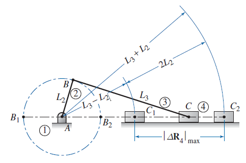

In-line slider-crank mechanism: has the crank pivot coincident with the axis of the sliding motion of piston pin.
) d0 S2 X5 `3 d; B! M$ s曲柄轴心与滑块运动轨迹共线。) m1 u3 s' M2 f
未命名图片.png - `& K+ x0 I( G3 U# h
In-line slider-crank mechanism produces balanced motion.
* i' K  S: m& m: z2 h' @% L* V该机构产生平衡运动。2 w: f& s: L. g  p- L7 K1 U

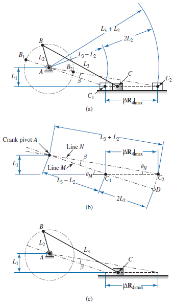

* _6 j' {) ^. L0 ?. zOffset slider-crank mechanism: has the crank pivot not coincident with the axis of the sliding motion of pin.) C/ j( A3 n( Z* q2 D8 Q" r# j$ W
曲柄轴心与滑块运动轨迹不共线。
; E' g, n3 X. o. @$ H0 q# i" z% ~ 未命名图片.png 9 C! p' j) d9 J& G, V
Determining an appropriate offset distance, L1, and the two links lengths, L2 and L3, to achieve the desired stroke, |ΔR4|max, and imbalance angle.# @8 t0 i6 a0 y6 A+ _! x. j+ ?7 V# A
确定补偿距离及构件杆长以获得需要的冲程、极位夹角。
* f6 ?1 e) V/ ^

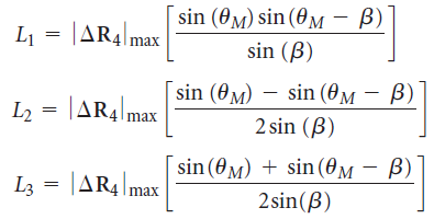

& l3 R2 H$ y  N9 g% bQuestions2 H4 R6 k# B3 a6 k: g7 u
The stroke, |ΔR4|max, and imbalance angle are given, determining an appropriate offset distance, L1, and the two links lengths, L2and L3.
! N. i' _9 |% o- u  ?5 x常见题型,给定冲程、极位夹角,确定补偿距离及构件杆长。
2 G5 U) F( Q+ q! O$ [  G8 @9 U1 v! X( u# l8 I
解题公式:

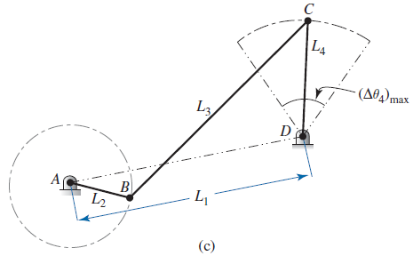

【20160328】Design of Crank –Rocker Mechanisms7 s5 U' o3 E6 @( _+ n8 A; \( j
- ^! ^# n5 _, a" T  |+ G& @4 g
The design of a crank-rocker mechanism-determining appropriate lengths of all four links to achieve the desired throw angle, (Δθ4)max, and imbalance angle, β.
* P4 k4 e+ i4 |曲柄连杆机构设计:给定极位夹角求四杆长度。4 H( O4 E/ t7 ?( y- \
8 A: ^! K* a3 S5 {, ZQuestions:
( V7 c" j9 E( O+ f2 TThe desired throw angle, (Δθ4)max, and imbalance angle, β are given.
3 v. e7 M- W. K9 @, i, kDetermining appropriate lengths of all four links.
' x8 o! U- x8 l, [典型问题:) u- H" i0 Q) W6 P
给定极位夹角求四杆长度。

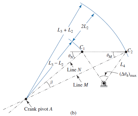

- A( Y# X" ?; z  E! x: S计算公式:9 C1 w1 s2 w4 g
未命名图片.png " M2 D) f2 K: p- v, O# }8 e
