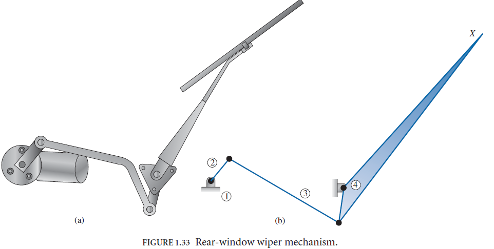

The mechanism for an automotive rear-window wiper system is shown in Figure1.33a. The kinematic diagram is shown in Figure 1.33b. Notice that this is afour-bar mechanism because it is comprised of four links connected byfour pin joints and one link is unable to move.9 x: k( p& `! t6 g
四杆机构判定条件:四个构件组成、四个销钉连接、其一不可动。( E6 u+ J+ Z8 B4 y/ ^4 r

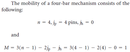

Because the four-bar mechanism has onedegree of freedom, it is constrained or fullyoperated with one driver. The wiper system in Figure 1.33 is activated by asingle DC electric motor.
, C4 L( ?- A3 A
四杆机构自由度为1。$ ~8 f) v, R) n5 {" q

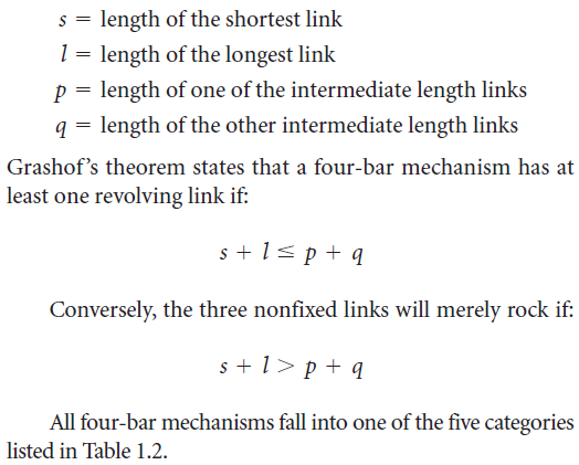

【20160323】Grashof 'sCriterion4 A  K- F, H/ i: Z  ]9 E( _
4 t& g! ^/ b4 W. @8 N
The following nomenclature is used todescribe the length of the four links.# r& ?2 Z8 d: q1 D# G+ z
Grashof定理,用于描述四杆机构。
1 X! ^* D7 A& q1 E1 } 未命名图片.png + r9 s3 ?1 j- G

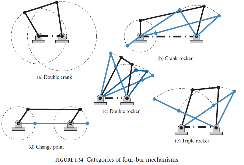

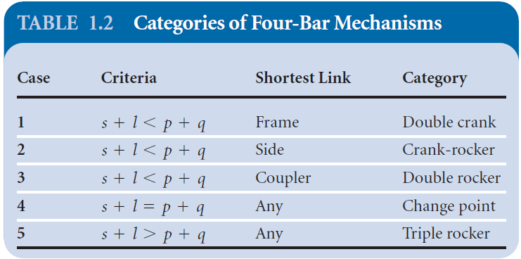

) Z  y1 d3 x9 a5 f+ M# R5 BThe different categories are illustratedin Figure 1.34 and described in the following sections.
3 d: D3 M/ }! O如图为不同种类的四杆机构。- N5 ]! z) |; u) Y; }
未命名图片.png 4 K& K7 B: n3 h7 ]% Y& a
* [4 L' y4 h0 d$ E8 x
主要为:
4 g% ]! z* B9 v* e9 h; B双曲柄机构(Double Crank
2 p" L: A  p% P' i* A1 e3 W, `曲柄摇杆机构(Crank-Rocker/ Y* j! x! n: \5 c. y( r; m
双摇杆机构(Double Rocker
% C& Z% ~% n1 _. B平移机构(这怎翻译)(Change PointMechanism
$ P( ]% I8 m' S' z* q" e三摇杆机构(Triple Rocker7 T& A# u; G- U
