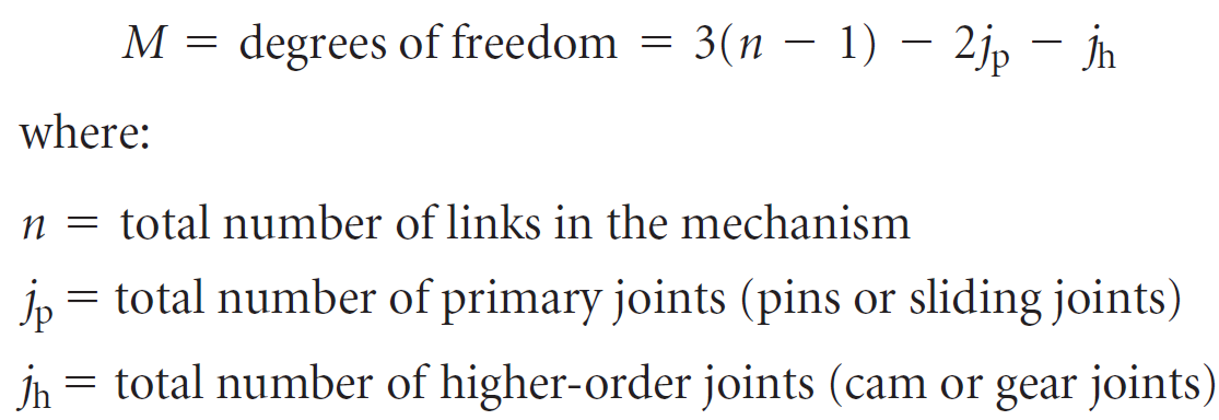

Gruebler'sEquation0 y# i: q& k0 [6 D6 i4 ?
1 Y% l7 y% a' R" r0 c
- X- N/ N1 B- _" K' n+ q) U
Degrees of freedom for planar linkages joined with common
joints can be calculated through Gruebler'sequation :
(寒假自学的一堆公式归结为一个常用公式了:3×总机构数-2×低副数-高副数,即为自由度)

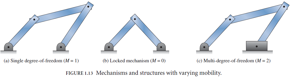

As mentioned, most linkages used in machines have one
degree of freedom.
Linkages with zero, or negative, degrees of freedom are
termed locked mechanisms.These mechanisms are unable
to move and form a structure. A truss is a structure composed
of simple links and connected with pin joints and
zero degrees of freedom.
Linkages with multiple degrees of freedom need more
than one driver to precisely operate them. Common
multi-degree-of-freedom mechanisms are open-loop
kinematic chains used for reaching and positioning, such
as robotic arms and backhoes. In general,multi-degree-of-freedom linkages offer greater ability to precisely position
a link. These mechanisms are shown in Figure 1.13.; v. C. n+ T3 k) h0 `: G

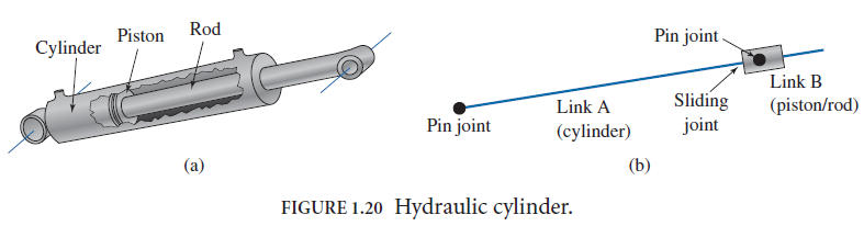

Hydraulic or pneumatic cylinders are common components used to drive a mechanism with a limited linear stroke. Figure 1.20a illustrates a hydraulic cylinder. Figure 1.20b shows the common kinematic representation for the cylinder unit.
& k; ~/ x: V+ ^气压/液压缸:冲程有限处。
' r9 W) p! c/ [6 o- P 未命名图片.png 7 ~9 o2 B* s- |! |  H
  d5 ]- Y2 Q! ^! o
The cylinder unit contains a rod and piston assembly that slides relative to a cylinder. For kinematicpurposes, these are two links (piston/rod and cylinder), connected with a sliding joint. In addition, the cylinder and rod end usually have provisions for pin joints.9 v6 [2 j& D( R2 ~. ~+ l) O
) k: C# u( S9 G# f+ c8 {. }/ v1 zScrew actuators also produce a limited linear stroke. These actuators consist of a motor, rotating ascrew. A mating nut provides the linear motion. Screwactuators can be accurately controlled and can directly replace cylinders. However, they are considerably more expensive than cylinders if air or hydraulic sources are available. Similar to cylinders, screwactuators also have provisions for pin joints at the two ends. Therefore, the kinematic diagram is identicalto Figure 1.20b.
4 s9 m: s# g) E/ g9 k; W6 `螺旋致动器:类似气压/液压缸,精确控制、有限冲程。

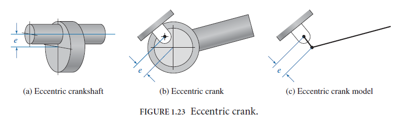

" [$ @3 O9 G! z$ a3 l3 R  F1 n% KEccentric Crank9 K" X6 A  H9 ^! q
On many mechanisms, the required length of a crank is so short that it is not feasible to fitsuitably sized bearings at the two pin joints. A commonsolution is to design the link as an eccentric crankshaft, as shown in Figure 1.23a. This is the design used in most engines and compressors.* K, d+ ]9 }% Y$ f' Y4 J
偏心曲柄,由于尺寸过小而不能保证铰合处销钉尺寸合适。# z" x8 f" p$ q5 `
( R4 S( [9 T" W; H0 a2 L6 nThe pin, on the moving end of the link, is enlarged such that it contains the entire link. The outside circumference of the circular lobe on the crankshaft becomes the moving pin joint, as shown in Figure 1.23b. The location of the fixed bearing, or bearings, is offset from the eccentric lobe. This eccentricity of the crankshaft, e , is the effective length of the crank. Figure 1.23c illustrates a kinematic model of the eccentric crank. The advantage of theeccentric crank is the largesurface area of the moving pin, which reduces wear.# [1 [0 m: D$ d% x6 I+ M0 c9 U+ p. x
因此将该销钉放大,以至于包裹整个曲柄。这个大销钉中心与曲柄转轴中心间的距离即为有效的曲柄长度。这样配置的好处在于移动销钉的巨大的接触面积,这减少了磨损。0 @7 _+ _( p" d; r4 ]; ^. A0 d

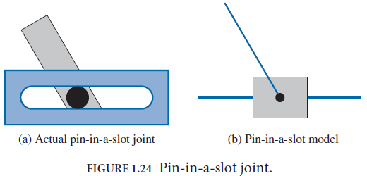

# l  _& n- F' ^$ |Pin-in-a-Slot Joint$ _9 k) e3 a  E1 l
A common connection between links is a pin-in-a-slot joint, as shown in Figure 1.24a. This is a higher-order joint because it permits the two links to rotate and sliderelative to each other. To simplify the kinematic analysis, primary joints can be used to model this higher-order joint. The pin-in-a-slot joint becomes a combination of a pin joint and a sliding joint, asin Figure 1.24b. Note that this involves adding an extra link to the mechanism. In both cases, the relative motion between the links is the same. However, using a kinematic model with primary joints facilitates the analysis.7 \* w9 O0 s8 g
注意滑槽是高副,包含一个滑动副和一个转动副。

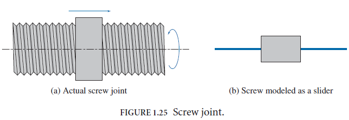

Screw Joint
- ~5 e: P& l6 @3 ^" RA screw joint, as shown in Figure 1.25a, is another common connection between links. Screw mechanisms are discussed in detail in Chapter 12. To start with, a screw joint permits two relative, but dependent, motions between the links being joined. A specific rotation of one link will cause an associated relative translation between the two links. For example, turning the screw one revolution may move the nut along the screw threads a distance of 0.1 in. Thus, only one independent motion is introduced.6 c7 U# _& J- w# \
螺纹连接只有一个自由度,因为轴向运动和转动是相关的。
# f- d) d: \  E; j2 B; z 未命名图片.png 3 @/ g+ d9 c( I6 e/ I$ \' e! [9 n# E
A screw joint is typically modeled with a sliding joint, as shown in Figure 1.25b. It must be understood that out-of plane rotation occurs.However, only the relative translation between the screw and nut is considered in planar kinematic analysis.
' L5 ^3 F2 c$ i+ f可以简化为平面铰接,但必须注意还有空间旋转,虽然在研究时不考虑。( _. }9 \% {4 j3 Z
