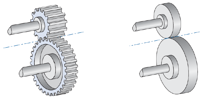

1 I$ e! W6 u# [% ~1 J! AIn general, the function of a gear is to transmit motion from one rotating shaft to another. In addition to transmitting the motion, gears are often used to increase or reduce speed, or change the direction of motion from one shaft to the other.
- {& D! U$ `$ a% v通常来说,齿轮的功能是在一个转动轴与另一个之间传递运动。除此之外,齿轮也常用于增速或降速,或者改变两轴的运动方向。
5 y  V3 @4 \, B3 b" T! H7 F5 M0 j9 L! k* m& d! S) }5 q% t
Friction rollers or disks that are also designed to transmit motion are less costly than complex gear configurations, but they may not be able to generate sufficient frictional forces and thus will slip under larger loads. To remedy the possibility of slipping, a gear is formed such that the smooth surfaces of the disks are replaced by teeth. The teeth provide a positive engagement and eliminate slipping.9 H5 o1 q* `0 }2 t5 H
尽管摩擦轮也可传递运动,而且比复杂的齿轮配置更加经济,但可能因摩擦力不足而导致打滑。为弥补这一缺陷,带齿齿轮取代摩擦轮成为了主流。带齿齿轮啮合更好,并能减少打滑现象。

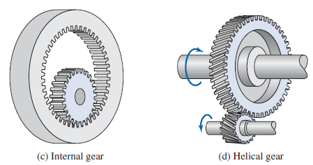

Internal or annular gears have the teeth formed on the inner surface of a circle. When mating with a spur gear, the internal gear has the advantage of reducing the distance between the gear centers for a given speed variation. An internal gear mating with a traditional spur gear is illustrated in Figure 10.3c.
7 T( I3 i2 T5 p! J内齿轮的齿在圆的内表面形成。与直齿轮啮合时,在给定的速度下,内齿轮能有效减少两齿轮中心的距离。图c为内齿轮与普通直齿轮配合。
/ h% u6 i; Y! q2 m6 d. T  a8 p
1 }. q% H9 q; W! w/ Q2 JHelical gears are similar to, and can be used in the same applications as, spur gears. The difference is that the teeth of a helical gear are inclined to the axis of rotation. The angle of inclination is termed the helix angle, . This angle provides a more gradual engagement of the teeth during meshing and produces less impact and noise. Because of this smoother action, helical gears are preferred in high-speed applications. However, the helix angle produces thrust forces and bending couples, which are not generated in spur gears. A pair of mating helical gears is illustrated in Figure 10.3d.% o+ o! T/ @0 k
斜齿轮与直齿轮有很多类似之处,不同的是它的齿与转轴有一定夹角,称为螺旋角。螺旋角使配合更平稳,产生的压力和噪音也更小。因此高速场合多用斜齿轮。然而螺旋角会产生轴向力与弯曲偶,直齿轮却不会产生。图d为喻队配合的斜齿轮。
1 q# p) h! O2 h* p: o/ [0 J 未命名图片.png ' {: g9 O5 b* s) y) ^9 M

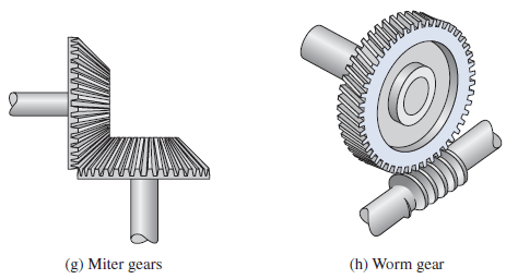

Miter gears are a special case of bevel gears where the gears are of equal size and the shaft angle is 90°. A pair of mating miter gears is illustrated in Figure 10.3g.# w2 m3 K0 ^& o- @8 V$ y
等齿数整角锥齿轮副是圆锥齿轮的特例,两齿轮有相同的尺寸,并且两轴成90°。图g为一对配合的等齿数整角锥齿轮副。9 H7 \+ c* _# ~# A  P6 l, x
) G5 Y9 ^# \9 |: ~, C( {
A worm and worm gear is used to transmit motion between nonparallel and nonintersecting shafts. The worm has one tooth that is formed in a spiral around a pitch cylinder. This one tooth is also referred to as the thread because it resembles a screw thread. Similar to the helical gear, the spiral pitch of the worm generates an axial force that must be supported. In most applications, the worm drives the worm gear to produce great speed reductions. Generally, a worm gear drive is not reversible. That is, the worm gear cannot drive the worm. A mating worm and worm gear are shown in Figure 10.3h.
+ J7 s' o( Y6 I3 c: f  w& Q蜗轮蜗杆用于传递不平行不相交轴之间的运动。蜗杆是指具有一个或几个螺旋齿,并且与蜗轮啮合而组成交错轴齿轮副的齿轮。这一螺旋齿也被称作螺纹。与斜齿轮类似,蜗杆的螺线产生轴向力。绝大多数情况下,由蜗杆驱动涡轮产生巨大的减速。一般来说涡轮驱动是不可逆的,也就是说,涡轮不能驱动蜗杆。图h为一对配合的蜗轮蜗杆。; n' ]; C! a# {! R* b6 ]  f! L
未命名图片.png 9 {/ F2 \/ f! }9 `! b  l) Q

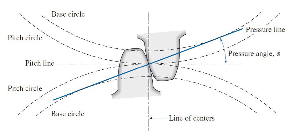

【20160410】Spur Gear Terminology
7 q+ \2 E, u3 m9 ?1 _5 d直齿轮相关术语
5 P% m! c+ ?! U  @+ r' w8 ~
& U# x' z% Z3 c3 Z3 I
Pitch circle: the circle that represents the size of the corresponding friction roller that could replace the gear.
, f( o( _, y  D8 p* [- \- i分度圆:代表对应摩擦轮尺寸的圆。; `( q) [# Z* d. g" p
未命名图片.png . a: T% V0 K$ j, z8 P4 X: H4 C
Pitch point: the point of contact of the two pitch circles.* o+ \- n7 g2 m8 n8 C0 e  x
齿轮啮合节点:两个分度圆的接触点。
0 B+ E2 T, v' W  G: j5 f: ?0 h' q. c1 Q$ F
Pitch diameter: the diameter of the pitch circle, also a widely referenced gear parameter.! T" a$ ]  R% z7 S' |; U
节径:分度圆的直径。也普遍被叫做齿轮直径。. i- X* w) I$ L. V
' B1 l" V" i5 C0 X( ?& g5 j4 C
Number of teeth(N): the total number of teeth on the gear.5 \( U+ s& G2 w) h8 T4 O: f2 |
齿数:齿轮上的总齿数。
! q, }& Y4 a8 A3 I0 [* _
; ^& x. r5 D5 x; lCircular pitch(p): the distance measured along the pitch circle from a point on one tooth to the corresponding point on the adjacent tooth of the gear.$ l, Q  \) \# @% S; b+ v
齿距:分度圆上一齿到临近另一齿对应位置的距离。
- N; B$ t. ~# _' W: j% |8 q9 F Cha 08-2016.jpg
! g/ Y- ?  F9 c2 I0 l$ YBase circle : the circle from which the curved shape of the gear tooth is constructed.6 m7 R5 _& d5 x
基圆:齿轮的齿从其上形成的圆。
1 ^8 _% J7 @0 s0 Y; t9 e
0 B& {& v2 m; g# g( _& J4 mFace width(F): the length of the gear tooth parallel with the shaft axis.& X( _7 Q7 n/ S
齿宽:齿轮齿的实体在轴向上的长度。
- b# J7 k) N* y) P8 k3 B; R' G+ q& E% v
Addendum(a): the radial distance from the pitch circle to the top of a gear tooth.7 M" [3 d* v8 u4 [
齿顶高:分度圆到齿顶的径向距离。
' h  o7 Q( C- q* F( Z
" D& j' v! Y4 gDedendum(b): the radial distance from the pitch circle to the bottom of a gear tooth.4 ]8 h5 r" n+ b% L* o
齿根高:分度圆到齿根的径向距离。" ~- H6 H; y( _
4 i2 w5 P. j* o7 J4 F' w( W
Whole depth: the height of a gear tooth and is the sum of the addendum and dedendum." X! ?; W3 d% ?! S( k) W9 g
总宽:齿的高度,也就是齿顶高与齿根高之和。
5 \. @8 u* r# O0 f8 e, a5 {, y( b
) J2 _* l9 F* O9 z. CDiametral pitch(Pd): the number of teeth per inch of pitch diameter; a standard for tooth size specifications.3 E4 W! ?& Q4 \- E+ u5 c
径节:节径上每英寸的齿数;作为齿轮大小的选择标准。
$ U8 o# d2 ?" R/ ]5 a+ k. e8 ~/ {1 i$ T: f/ Y
Module(m): a relative measure of tooth size. It is defined as the ratio of pitch diameter to the number of teeth in a gear.2 Z- M6 @  `) R) E3 v9 V
模数:齿大小的衡量标准。定义是径节与齿数之比。, o, g; L9 n' }0 R
; L/ v, H1 ?0 `+ MPressure angle(&#981;): angle between the pitch line and the pressure line.' z# E$ K; c5 v
Because the pressure angle affects the shape of a tooth, two mating gears must have the same pressure angle.3 B! N& v- D& h9 V3 o' i5 z
压力角:节线与压力线间的夹角。影响齿轮形状,因此配合的齿轮必须有同样的压力角。4 N8 i) Q0 H8 N) K6 P7 @+ X4 s. V
% l* b' W* T4 M$ p) CPitch line: the line tangent to the pitch circles.
5 _! x7 Z, K' v6 z# o: D节线:与分度圆相切的线。' b  t! p2 T' B4 L# g1 s! A: e3 b
8 U7 E* k3 D3 B9 q" e* s* z
Pressure line: the line perpendicular to the surfaces of the teeth at the contact.
7 h" t6 d6 D# n* F! b压力线:与齿接触面垂直的线。4 F4 g7 A. B5 m5 l9 ^( o# k

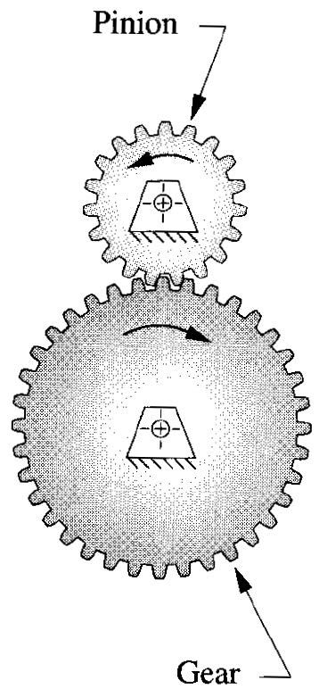

【20160411】Fundamental law of gearing5 x* h( o0 j3 Z+ o5 P
Cha 08-2016.jpg   e$ T' e" R- q5 c+ d- y) Z2 D
Fundamental law of gearing:the angular velocity ratio between the gears of a gearset remains constant throughout the mesh.
2 [+ j( B3 p! X4 V; ]齿廓啮合基本定律:啮合过程中两齿轮的角速度之比保持不变。

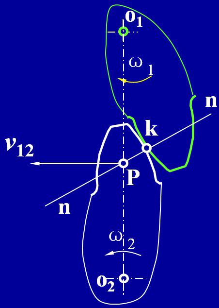

8 Q" p8 q. R, F6 v; M; e
6 r+ h, {; F! W: f* ?( V  i8 N$ B 1.jpg 0 B  p: K' m: ~: c* e+ R$ n: H, b: l- }
! W1 m4 f. W# `( F7 y" R; b6 WP: instant center.
$ }' L& P. g% |0 p8 W- ?0 _. b% ]8 uP点为速度瞬心。
/ s( Q' U% V" U  x2 w1 vVelocity ratio:7 I7 K/ e6 l: A% d6 J4 i
未命名图片.png 8 s% C- U$ x+ v9 l0 P- x$ z$ |4 G
Constant velocity ratio:point P should be fixed.
( n3 s( o# G. d7 s1 h0 B3 b- Y速度比恒定的意义:P点固定。
