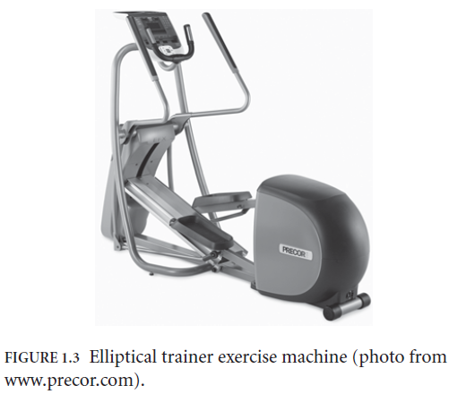

As stated, mechanisms consist of connected parts with the
objective of transferring motion and force from a power
source to an output. A linkage is a mechanism where rigid
parts are connected together to form a chain. One part is
designated the framebecause it serves as the frame of reference
for the motion of all other parts. The frame is typically
a part that exhibits no motion. A popular elliptical trainer
exercise machine is shown in Figure 1.3. In this machine, two
planar linkages are configured to operate out-of-phase to
simulate walking motion, including the movement of arms.
Since the base sits on the ground and remains stationary
during operation, the base is considered the frame.

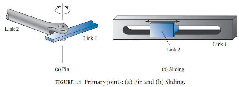

A joint is a movableconnection between links and allows
relative motion between the links. The two primaryjoints, also
called full joints, arethe revolute and sliding joints. The
revolutejoint is also called a pin or hinge joint. Itallows pure
rotation between the two links that it connects. The sliding
joint is also called a pistonor prismaticjoint. It allows linear
sliding between the links that it connects. Figure 1.4 illustrates
these two primary joints.

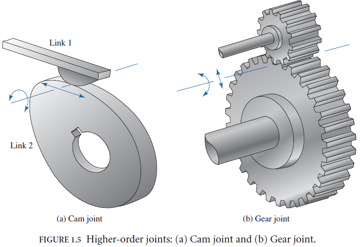

A cam joint is shownin Figure 1.5a. It allows for both
rotation and sliding between the two links that it connects.
Because of the complex motion permitted, the cam connection
is called a higher-order joint, also called half joint. A gear
connection also allows rotation and sliding between two
gears as their teeth mesh. This arrangement is shown in
Figure 1.5b. The gear connection is also a higher-order joint.

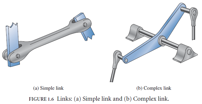

A simple link is arigid body that contains only two
joints, which connect it to other links. Figure 1.6a illustrates
a simple link. A crank is a simple link that is able to complete
a full rotation about a fixed center. A rocker is a simple link
that oscillates through an angle, reversing its direction at certain
intervals.
A complex link is arigid body that contains more than
two joints. Figure 1.6b illustrates a complex link. A rocker
arm is a complex link, containing three joints, that ispivoted
near its center. A bellcrank is similar to a rocker arm, but is
bent in the center. The complex link shown in Figure 1.6b is
a bellcrank.

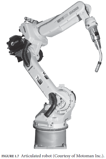

Linkages can be either open or closed chains. Eachlink in
a closed-loop kinematic chain is connected to two or more
other links. The lift in Figure 1.2 and the elliptical trainer of
Figure 1.3 are closed-loop chains. An open-loop chain will
have at least one link that is connected to only one other
link. Common open-loop linkages are robotic arms as
shown in Figure 1.7 and other “reaching” machines such as
backhoes and cranes.
