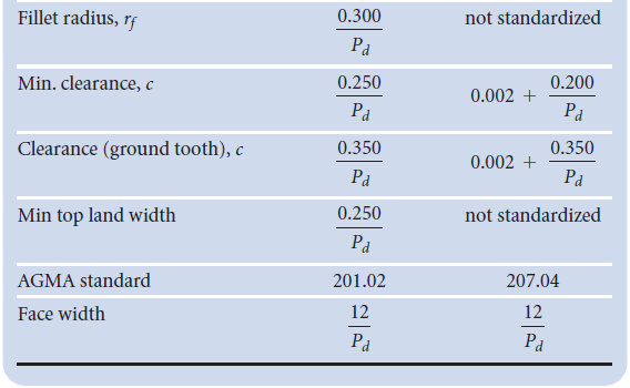

The standardized values of diametral pitch:
4 A! V( z2 Z+ D# `$ W- I标准径节值如下表:* e+ n* t2 V8 N3 V; ?6 B2 I
未命名图片.png 4 r. h5 r4 U) X$ }
6 f* `: ]- j$ F) R$ v  h9 x1 W, h8 s$ A* ?: M4 |! Z$ I6 B

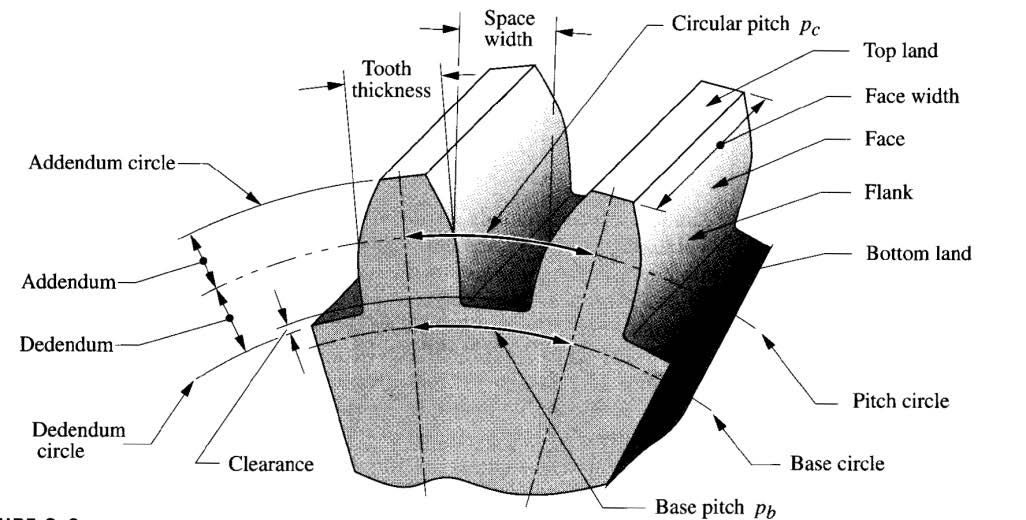

The manufacturers must follow a standard convention to form the details of the gear tooth profile. The AGMA is the primary organization that oversees this standardization scheme.
& y6 v) ^- [; |5 R9 ~( Q齿轮齿廓的加工必须遵循一定规则,美国齿轮制造协会首先制定相关规定。

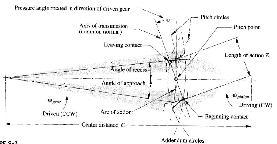

【20160414】Relationships of Gears in Mesh
' C2 B; c- n  K* W( @9 J" k& S3 y# S4 N$ C$ |: G8 v8 L) t
Center Distance
" g; _  p# [7 H! ?) Z/ |+ J Cha 08-2016.jpg
; L7 X6 y9 Z3 B; U1 T# _Pinion-the smaller gear  小齿轮
3 G) n5 A4 E! ?; \# g9 QBull gear or gear -the larger gear  大齿轮

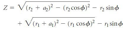

: U/ O% L6 c/ }% u# pContact ratio( mp ): the average number of teeth that are in contact at any instant.) m0 ^- {/ k% }: q& R. a; [9 B
重合度:任意时刻相互接触的齿数。
* G* w% j  F1 x Cha 08-2016.jpg & I9 C+ \; m3 E' M0 s3 d! [
where  ?2 A! ^5 j/ C$ L7 }( w7 w& y
Z -The length of the contact path( length of straight line)
. d5 \+ T9 H2 z) e9 ^1 @pb-The base pitch, which is defined as the distance between corresponding points of adjacent teeth, measured on the base circle( length of arc )9 ^- ?' ]' i2 o* ^; l
啮合度=接触长度(直线长度)/节距(弧线长度)

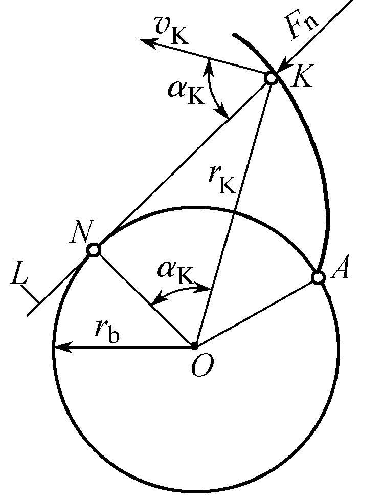

+ L! Z# M( F# ?' D% aAn involute shape is constructed by unwinding a taut wire from a base circle.
' f# j: @) h3 U渐开线的形成方式决定了直线段KN与弧线段AN的长度相等。( G  Z7 M% B4 \/ ]: k; l1 L

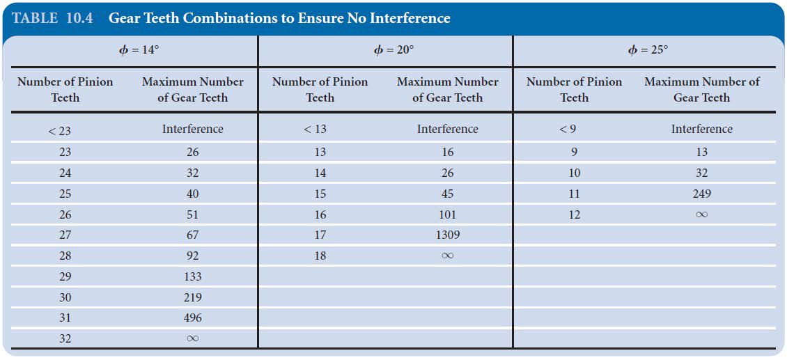

8 ^+ u% m$ t3 ]2 q  z. YTo avoid interference,the maximum number of gear teeth is given as8 A4 }6 m7 O0 t! P4 ]
1 B% d3 @  E; s; p" S; G为避免干涉,最大齿数应满足如上公式。
