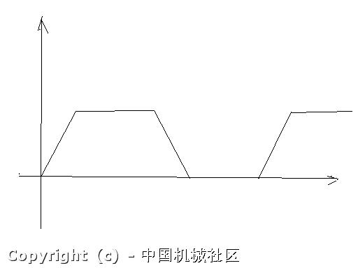

想要在刚体上加一个如附件中所示函数(周期函数)的力,请问那位高手能帮忙把这个函数编出来,谢谢啊!急啊!
发表于 2008-5-11 20:05:37 | 显示全部楼层
step(time,0,0,t1,y1)+step(time,t1,0,t2,0)+step(time,t2,0,t3,-y1)+step(time,t3,0,t4,0)+step(time,t4,0,t5,y2)+step(time,t5,0,t6,0)' u2 I: y+ C' S8 ^. [# E1 v2 U& J
tx为图中每一个时间点,y1为y轴的值! [7 O. H/ `9 A# q$ h2 e; r
你试试,不知道对不
发表于 2010-4-10 17:06:26 | 显示全部楼层
step(time,0,0,t1,y1)+step(time,t2,0,t3,-y1)+step(time,t4,0,t5,y2)
