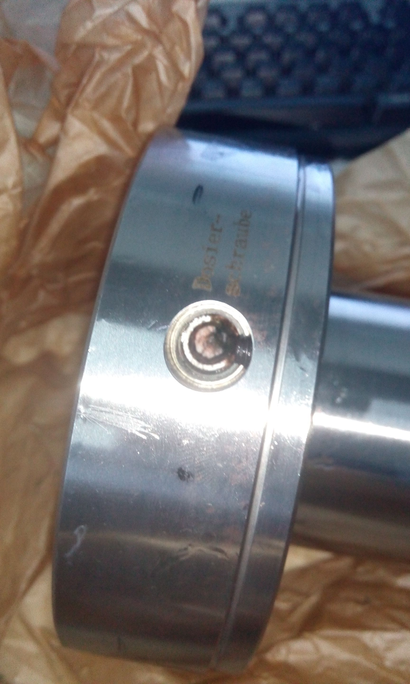

胀紧夹杆的dosier孔能不能调节圆度

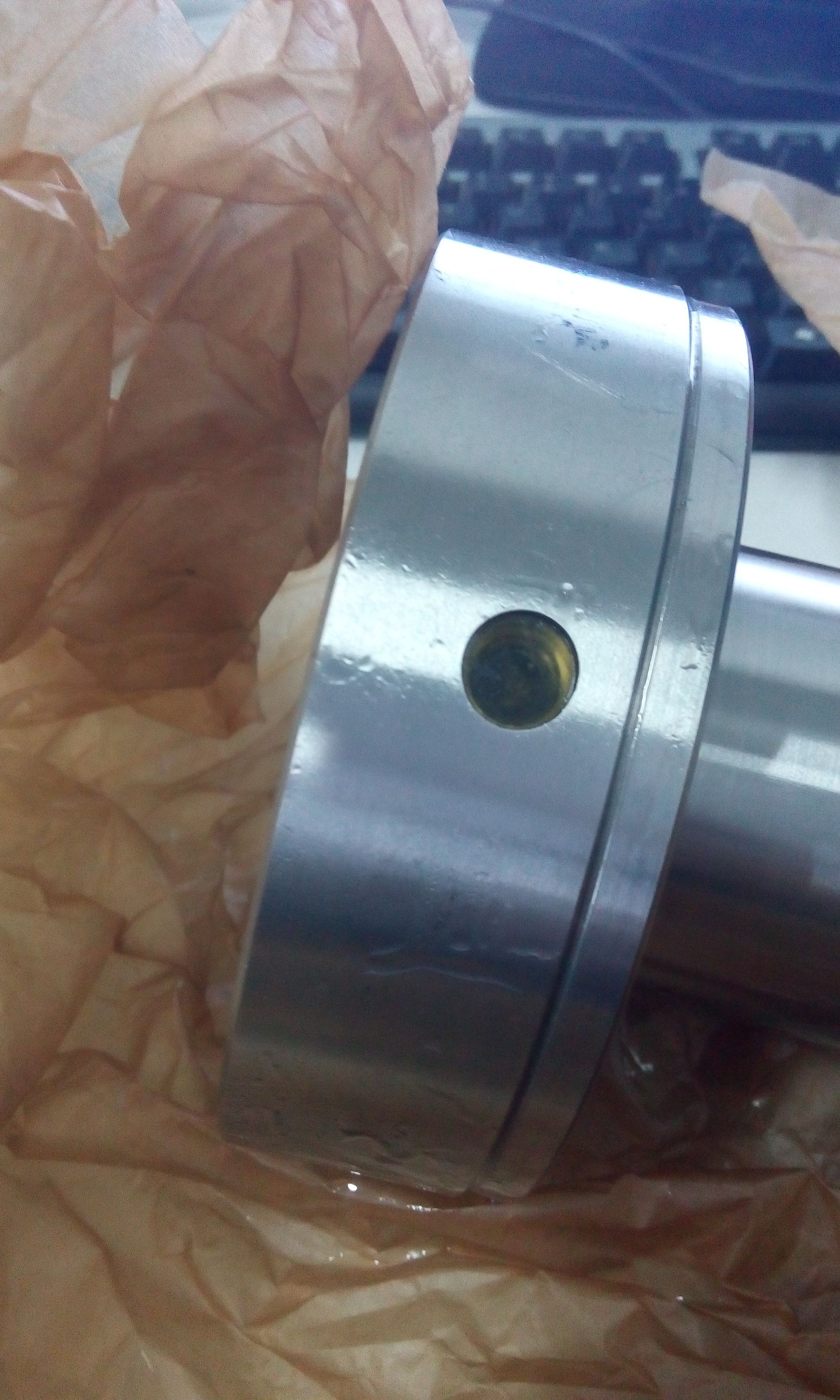

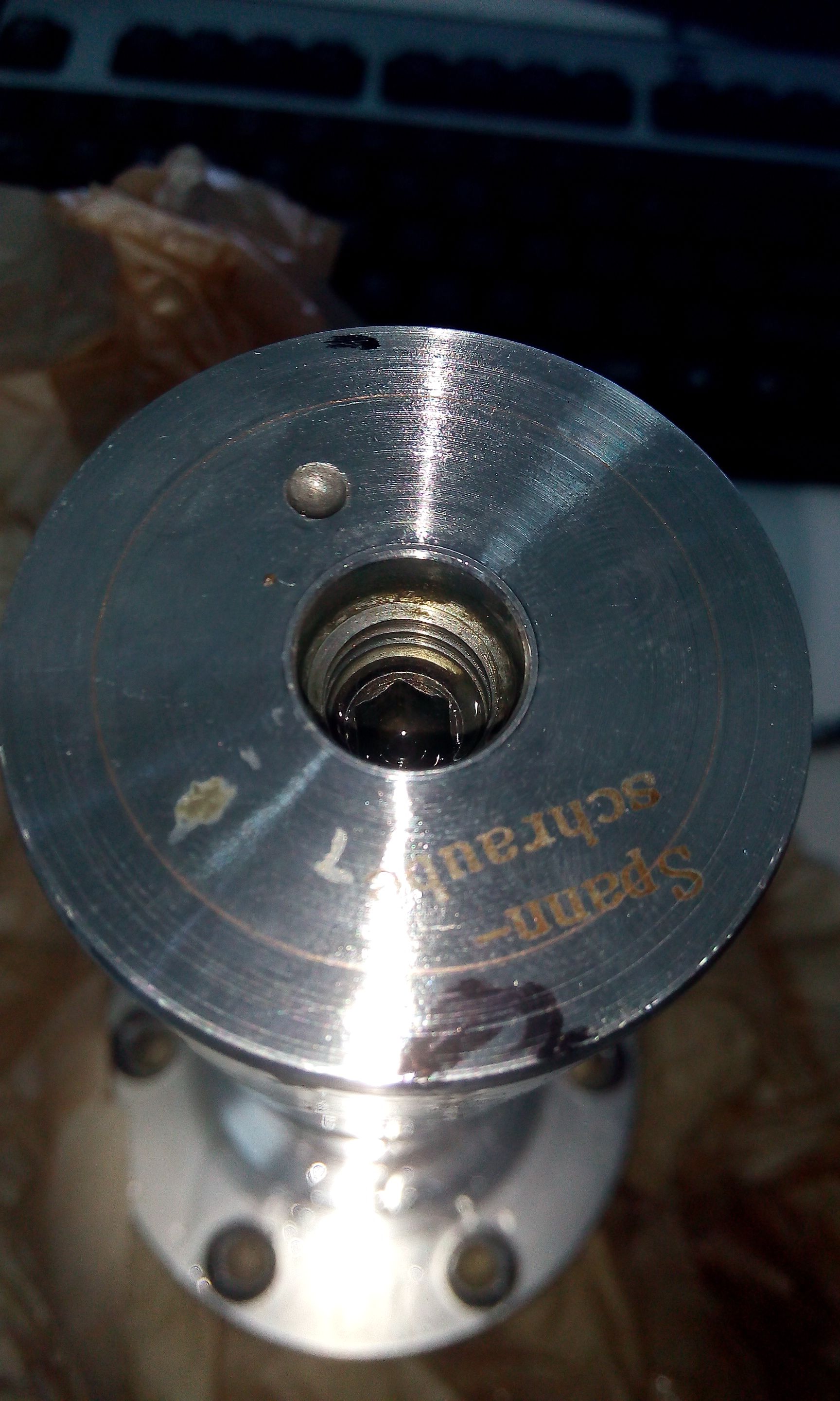

 楼主| 发表于 2015-8-25 09:02:16 | 显示全部楼层
joseph8779 发表于 2015-8-21 08:02
+ i$ l6 s- Q. _9 l+ P2 Q9 QHi, Starsea, show you a picture
  n/ T0 A) G. K2 S5 M) V抱歉,回复晚了。
* R5 v3 W) p; B有3个也。柱顶的那个孔调胀紧。
, r* k- U2 w5 k) S" t5 B底座有2个孔。5 j; \( X9 _  y; A) |+ T
1个小的被密封了。
+ C( d1 j" f% p6 S# K! U另一个大的里面有螺丝。标有DOSIER.
" @) [2 H% D8 u( |& S- _  O. B我问的就是这个DOSIER孔。

发表于 2015-8-25 09:48:36 | 显示全部楼层
starsea2 发表于 2015-8-25 09:08
9 p6 t0 n8 r4 EYou can find out yourself by using compressed air to see how the oil flows. I'm not sure exactly how the dosier works on this fixture manually or automatically. To my understanding it could be both: in manual mode, you can expand the fixture by turning the 调胀紧 screw. if it is applied in automatic mode, the doiser hole is connected to hydraulic supply station, the fixture works when the pressurized oil is pumped in through the doiser hole.   }9 t" ~) g$ D; W

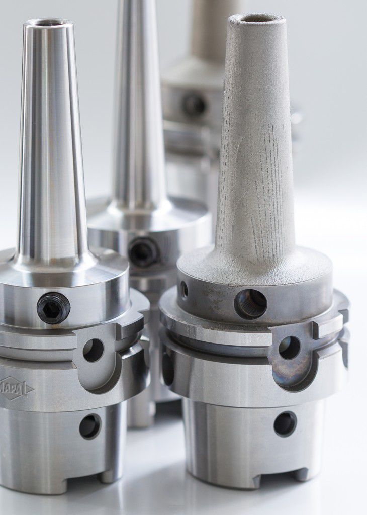

发表于 2015-8-25 10:47:26 | 显示全部楼层
看上去就是一个液压夹持原理的,链接主轴的一个holder啊。就像楼上展示的MAPAL的液压刀柄,工作原理一样的。有锁紧螺钉(驱动螺钉),也有泄压螺钉(一般情况下胶水密封住)。
