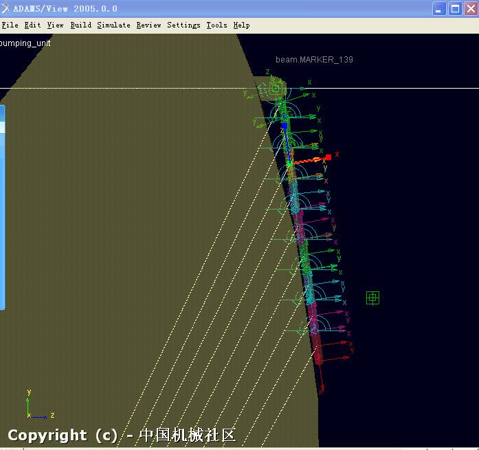

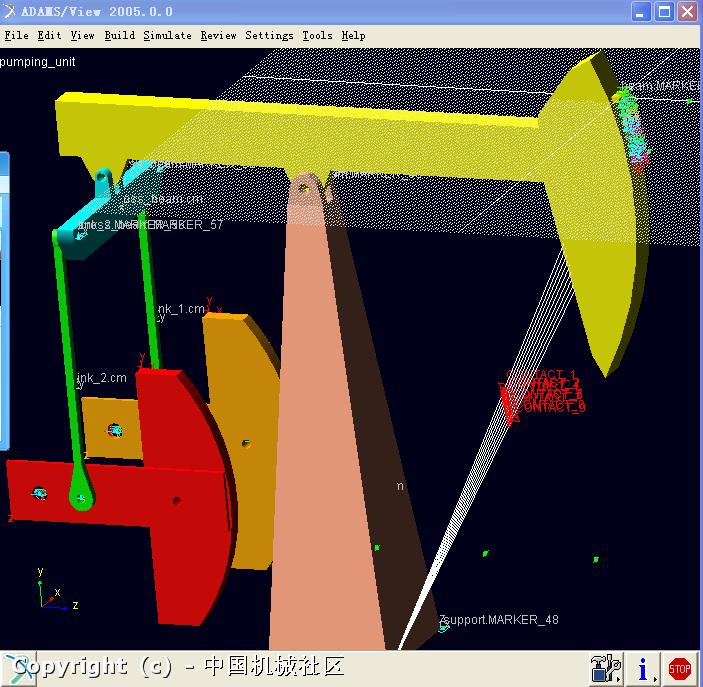

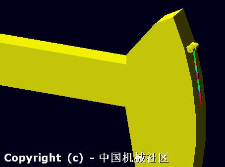

我用ADAMS做游梁式抽油机的仿真模型时,对驴头处的钢丝绳用连杆代替,并定义其与驴头的接触碰撞,但是仿真进行不下去了为什么啊?

报错及警告:
W: Q: g% p2 P
WARNING:    ++++++++++++++++++++++++++++++++++++++++++++++++++++++++++++++++++++++++++++
   NOTE:  The set of redundant constraints has changed at time = 0.0.
ERROR:   Abnormal termination encountered in ADAMS/Solver.
ERROR:      The simulation stopped at time = 0.0.
   The equations of motion can not be solved at this point because of a
   singularity in the Jacobian matrix.  This singularity is due to the
   equation for PART pumping_unit.PART_39 ( PART/39 Xdot ).
ERROR:      The matrix is numerically singular.

兄弟 我看他那处应该是柔性体,然后楼主用flexlink做成刚体,本身adams对这种仿真形式就不能很好支持。建议用有限元软件做成柔性体,导出mnf文件。而且你最好把你的模型贴上来,否则很难判断问题

我也碰到这个问题了,没有高手解决吗,,,所有约束副加上就有问题,去一个就可以运行。。。
