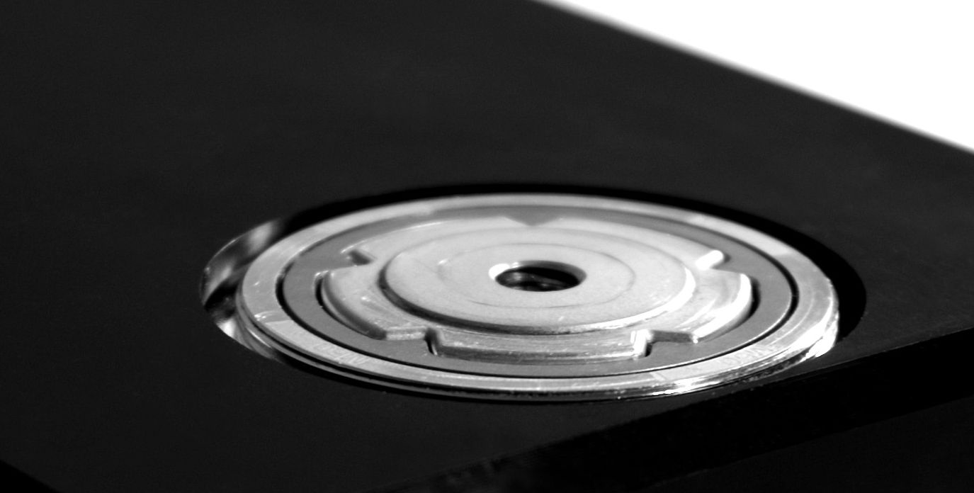

國外一種千斤頂...很不錯的設計

没看到里面结构,不清楚原理

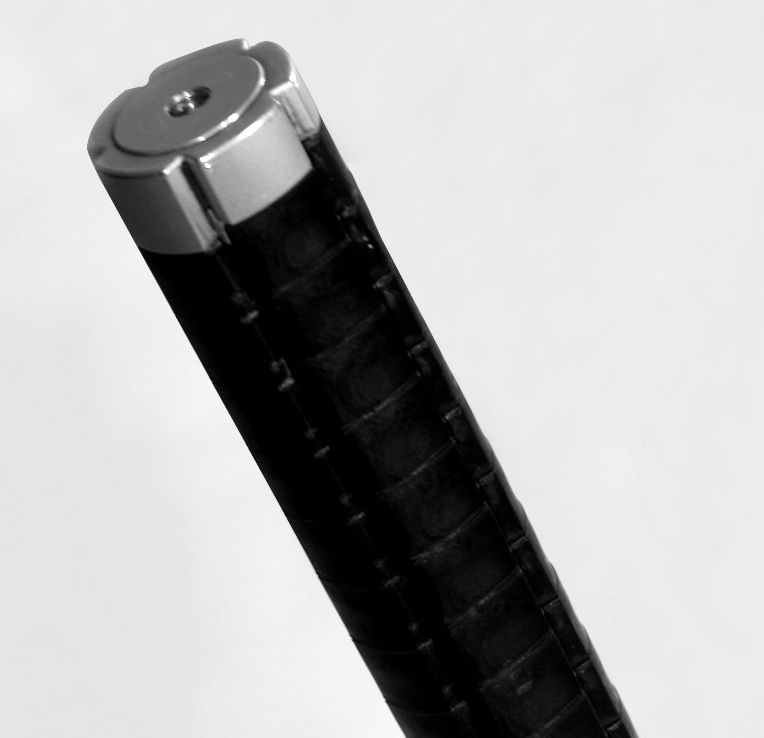

http://www.kataka.dk/pages.asp?id=48
关键词查 Segmented spindle
可惜了, google, yahoo, bing这些国际搜索引擎在国内都不好用。
链接里的动画一般都看不了, YOUTUBE被封了。
链条和轴销的完美结合。由外形相同的零件组成一个传统的轴销。可比喻为3D立体拉链。
Technology
KATAKA is focused on the work on the segmented spindle which is a completely new mechanical technology. It combines the best properties of the chain with the best properties of the spindle.
This means that there are almost endless opportunities for making new products based on the technology. However, it also implies that the boundary conditions are not explored in great depths for some areas.
The performance depends on a multitude of parameters, e.g. the choice of materials, the load levels, the amount of cycles required, the temperature etc.
We have calculated dynamic load levels from 200g up to 6tons for actuators based on the segmented spindle technology.
The segmented spindle
The segmented spindle consists of uniformly shaped elements, which can be coiled together. In the world of mechanical engineering, this is a completely new way of solving an old problem. Some call it a 3D zipper, others call it an Indian Rope trick.
When not coiled up the segments are linked together in a flexible chain which can be stored in an almost arbitrary shaped container.
There are not any textbooks available on the statics, kinematics and dynamics of this type of technology yet. We had to do our own testing and calculation models to get things right. We even had to come up with our own name for the technology.
When a lot of segments are joined together, it resembles a conventional spindle, however it does not need to have any threads at all or all the threads can be placed vertically. Consequently, we chose to call the technology for a segmented spindle.
The segmented spindle technology is protected by several patents (granted and pending). It is a radical new and different way of combining compactness with the advantages of the well-known and well-proven conventional spindle and the equally well-know chain.
发表于 2014-11-28 16:01:38 | 显示全部楼层
看不懂啊,蒙圈

我真的 没看明白 那些看明白的指点一下

这么长的杆子怎么隐藏起来呢??用什么原理升起来呢?
