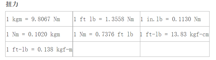

发表于 2020-9-16 10:28:04 | 显示全部楼层
in----inch(英寸)-------约2.54cm=0.0254m
lb----pound(磅)----约454g=0.454Kg----合4.4492N
in-lbs-------合0.0254m×4.4492N≈0.113N·m
