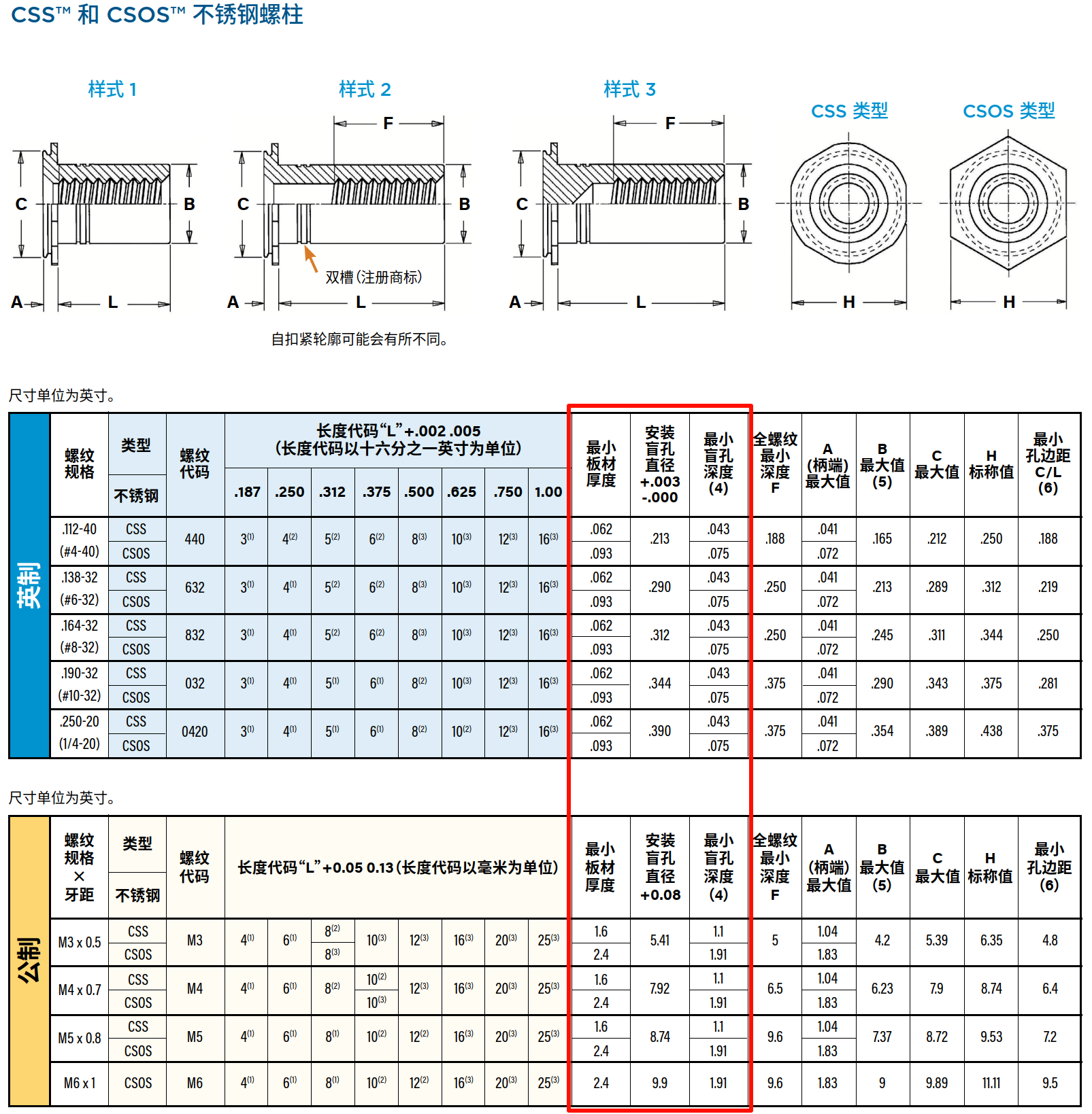

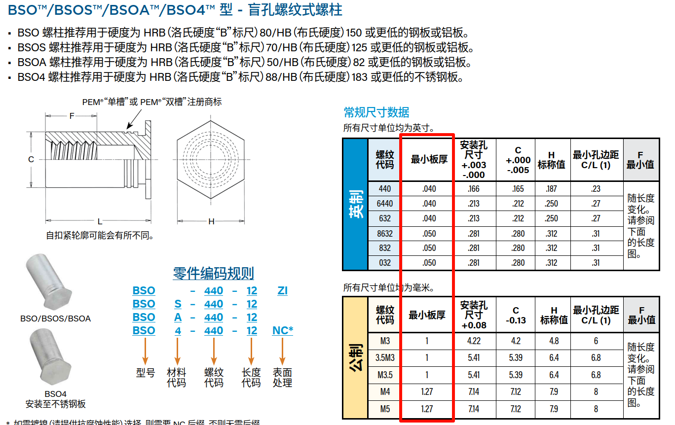

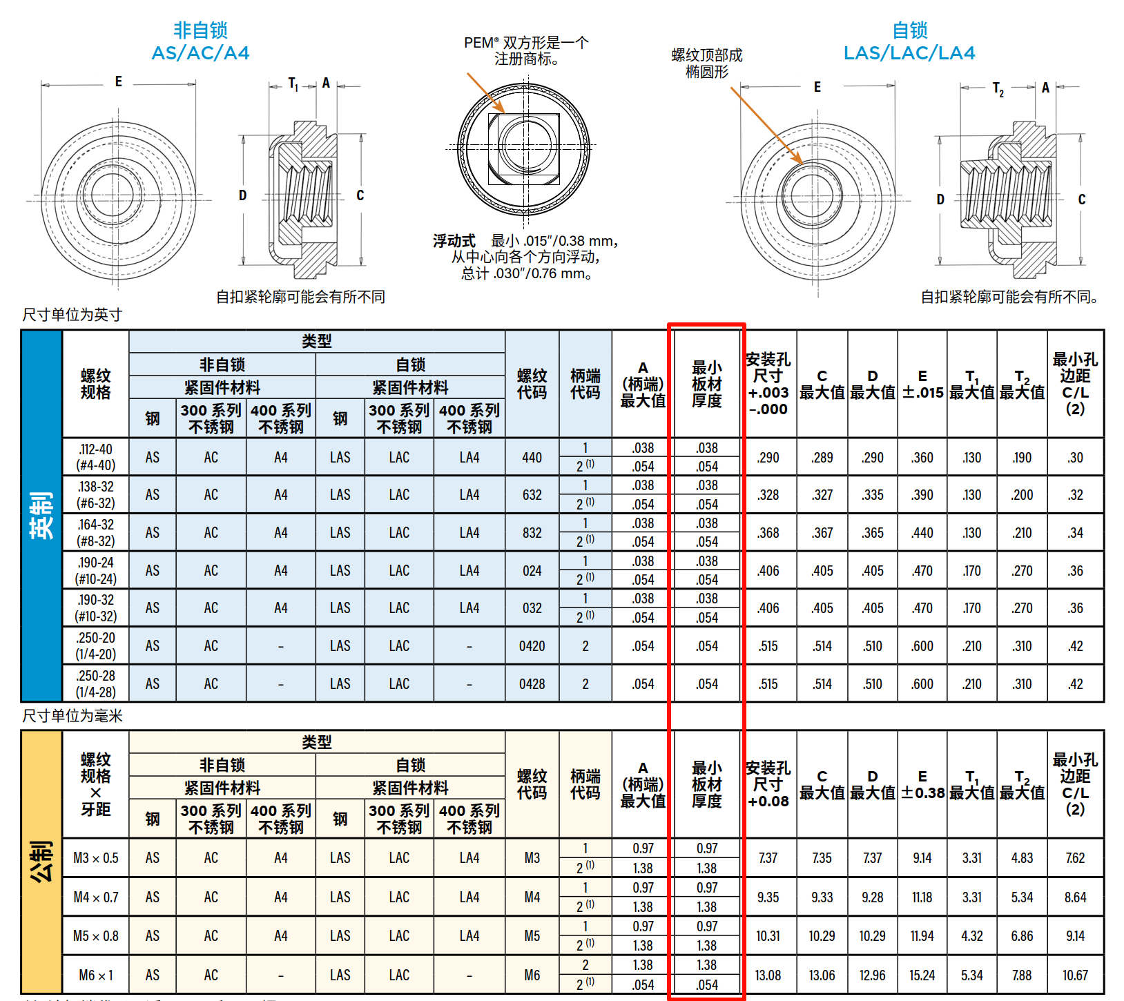

发表于 2025-6-10 13:40:11 | 显示全部楼层
PixPin_2025-06-10_13-39-45.png PixPin_2025-06-10_13-36-13.png PixPin_2025-06-10_13-32-48.png
