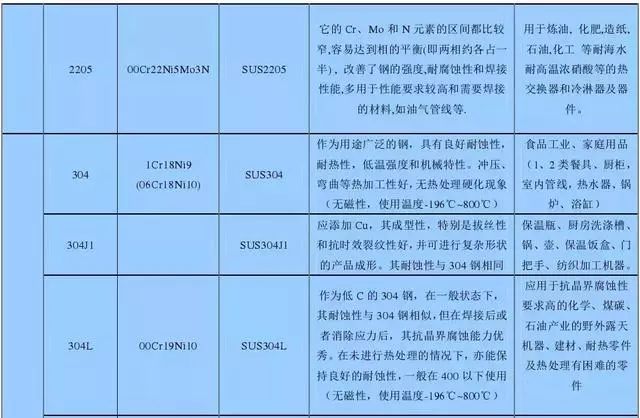

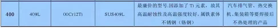

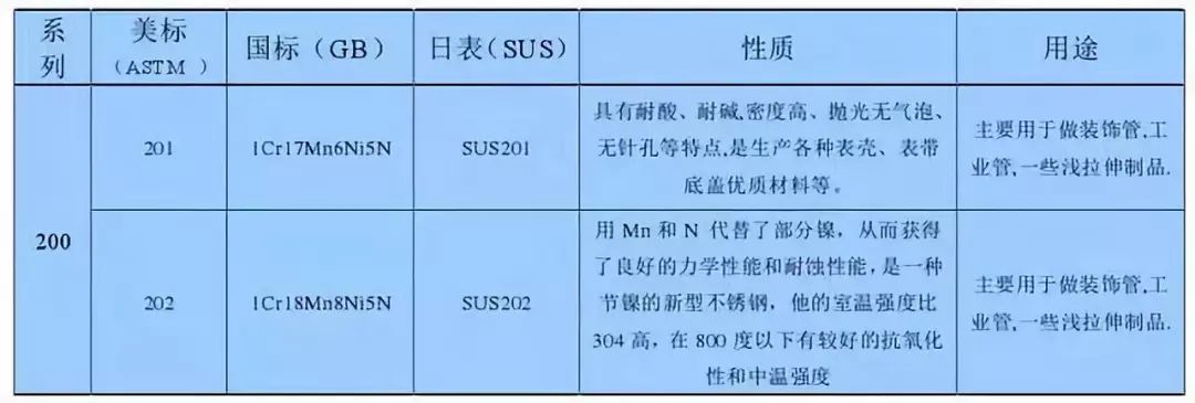

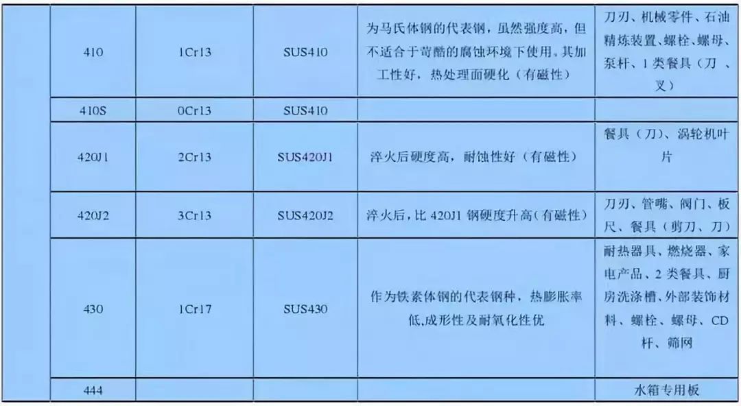

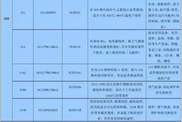

特性和用途
4 \, M" _& r# D! [( O  l
/ R. y+ U- f4 W7 ^
; B+ K1 e6 w% l7 `" r
2 m, v1 P- [+ b5 B( S6 Q& s$ c" R
5 y6 [6 X4 W4 d; h6 d( w. U
: ?, y' L7 x5 U1 Z- ]
" M) g6 t& Q$ W* T3 J' l- P
+ e, n5 V8 V; ]6 Z% K: C
/ B, p* {# _$ g  p. z) e9 g7 q8 l# C
6 _  }+ X6 W& S! [* b0 d, [

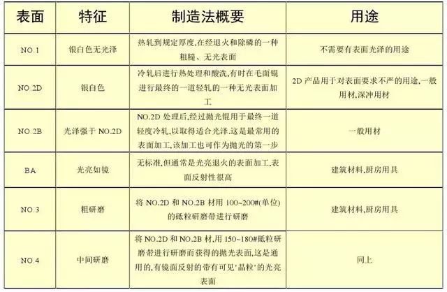

表面工艺
