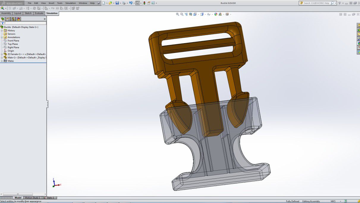

    Being a responsible (and fun…) parent, I make my daughters wear life jackets when canoeing, and one day while paddling I was thinking on how much trust we put in products every day.  I trust those life jackets to protect my girls.  You might think, how is this related to SOLIDWORKS and design? Good question… Well, I realized that in order to keep my daughters safe, the key component of these life jackets are the buckle clips that keep the jacket securely fitted. These buckle clips are made of plastic, they need to be easily and securely inserted but be secure enough to not open when pulled on  j. s! H; l7 ^7 M1 `1 Y
    救生衣的安全扣夹和重要性* y* j0 d5 V7 i4 G
    1.jpg ; o$ B! {; R( n0 d8 S/ E& D
    It so happens that Nick, one of my English coworkers (yes the French and English can get along!), was working on a clip buckle design and I suggested that we use simulation to help guide the design process.  Now if you are a simulation guy you might know that the analysis of a clip buckle design involves the simulation of a snap through behavior which is not simple to simulate as it involves contact with large deformation and spring back which is a combination of highly non-linear effects.  In addition, the plastic material of the clip buckle has a nonlinear load deflection response8 [* k/ J9 f. P2 B! K

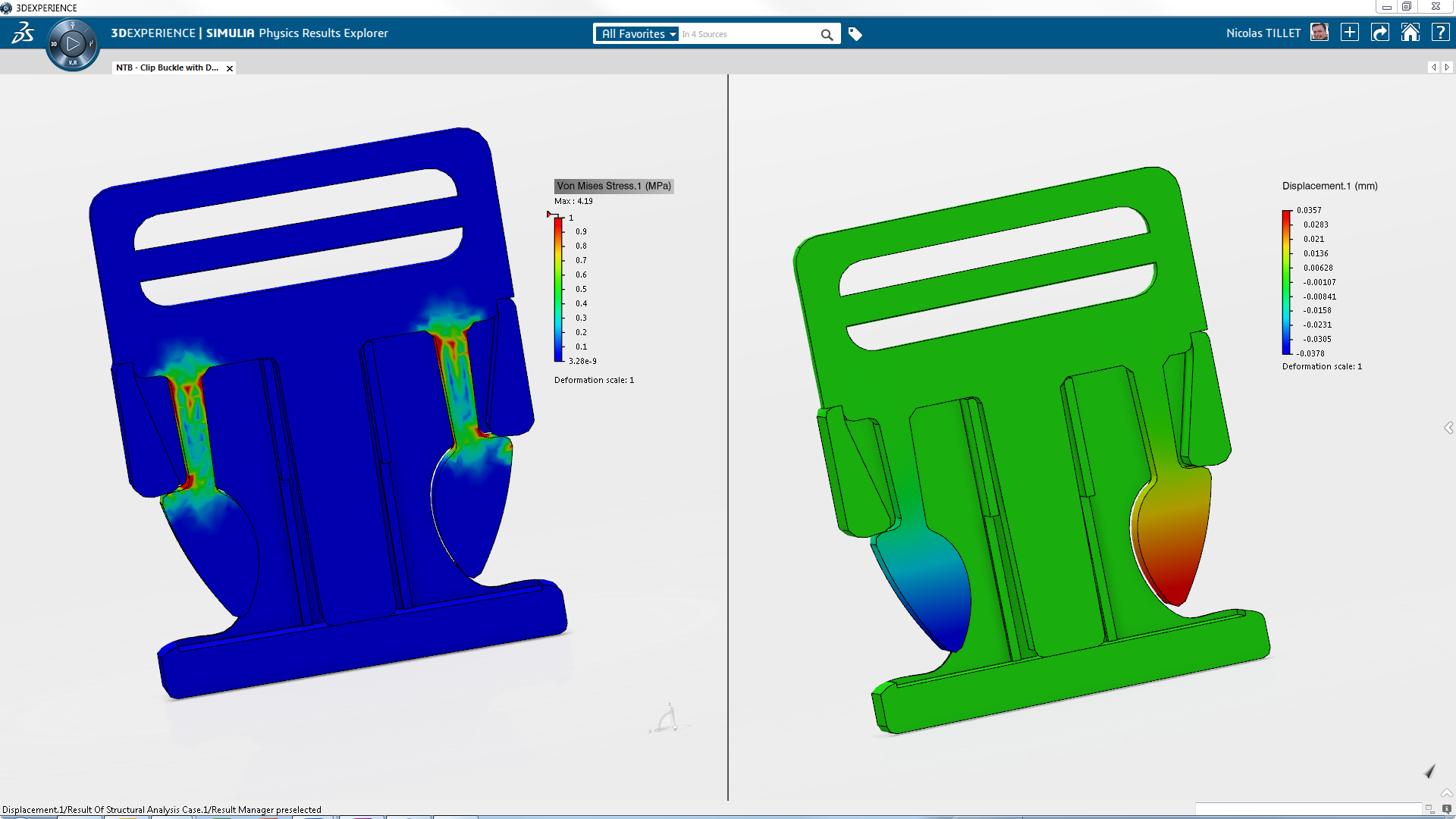

      ?" i3 V% ^  O+ i; \- B# pThe new SIMULIA apps deliver the power of Abaqus, the best non-linear FEA solver on the market, with a refined user interface that allows designers to tackle challenging problems with ease.  With Structural Analysis Engineer it a snap to hold the buckle and push the clip in after setting up the plastic material and component contact conditions.  After a few minutes to model the problem and a few minutes to solve it… voila!
    % ?* f; _) @7 Z新的应用程序SIMULIA Abaqus所传达出来的,市场上最好的非线性有限元求解器,具有精致的用户界面,为设计人员解决具有挑战性的问题提供方便。随着结构分析工程师能够轻松地握住带扣,推动设立的塑料材料和部件接触条件后的剪辑。几分钟后进行建模,并在几分钟来解决它...瞧!: o; O* h! F8 k- s# t5 W
