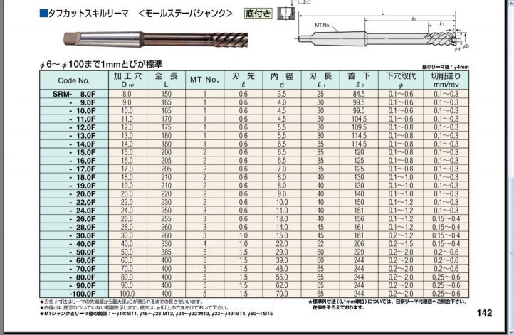

发表于 2009-12-23 21:38:23 | 显示全部楼层
